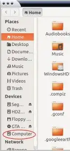

Nautilus use to have the label for the file system in it's tree as "File System". Recently that was changed to now show "Computer" in the tree to open the file system. Regardless of why this change was made, how do I change it back?

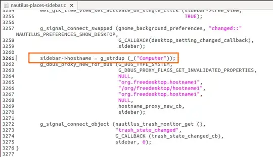

6) Edit the file "nautilus-places-sidebar.c"
Search for the line 3261 to edit.
Replace "Computer" for "File System".
To edit:
  • gedit nautilus-3.6.3/src/nautilus-places-sidebar.c
BEFORE:
sidebar->hostname = g_strdup (_("Computer"));
AFTER:
sidebar->hostname = g_strdup (_("File System"));
In one command would be:
  • sed -i '3261s/Computer/File\ System/' ~/Downloads/src/nautilus-3.6.3/src/nautilus-places-sidebar.c

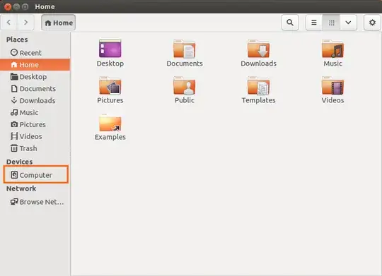

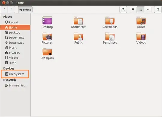

9) Finally you can logout and Login to see the changes.
BEFORE:
AFTER:
Hope it helps.
