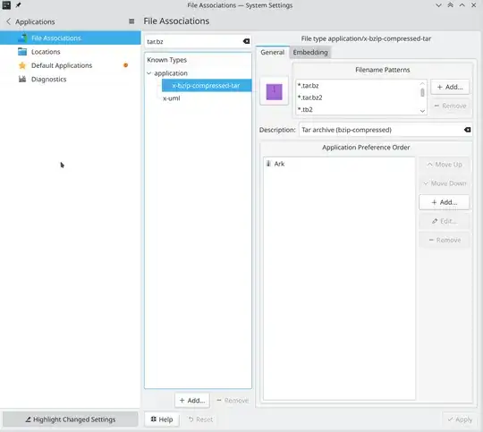

Ok, I have found the solution. System Settings, go to File Associations, expand application and click on x-bzip-compressed-tar and then update applications or sort them by your priorities.
In my case it opened also any plain text file like sha512, so I had to update different type, but the principle is still the same.
Screenshot
