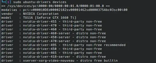

The output of sudo ubuntu-drivers devices

You have learned that you cannot randomly throw packages/libraries together from different sources and expect things to work. Nvidia drivers (either 470 or 495) and steam packages are available from the standard repos (restricted, multiverse) -- use them. CUDA does offer a .run file for installation which allows you to put libraries and executables into your own directories instead of system areas (avoids the crazy dependencies of trying the deb installation route or polluting system areas with wrong versions of things). Skip any offer of an Nvidia driver, you got a working one from the standard repos.
how to install cuda
cuda location selection
Clean out all the unnecessary steam and cuda, and who knows what else from your repositories. Ensure the multiverse and restricted selections are made from the Software and Updates/sources tab, then update your package info with sudo apt-get update then just install the desired cuda drivers and steam. The steam package may need the 32 bit libraries, but you probably got those already. The only steam packages I have are steam:i386, steam-installer, and steam-devices, and steam games run fine.
