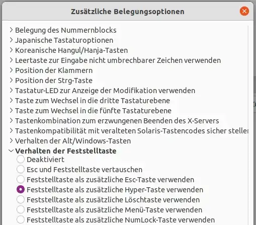

I made CapsLock the Hyper-key via gnome-tweaks
Sorry, I have only the german screenshot. "Feststelltaste" means "CapsLock"
gnome-tweaks-capslock-de

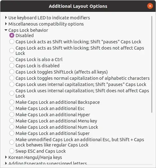

When Caps Lock behavior is set to default, i.e, "Disabled"
Caps Lock behavior set to default
create .xmodmap file with below content,
keycode 66 is the Physical Caps Lock Key on My Keyboard
clear lock
keycode 66 = Mode_switch
add lock = Mode_switch
keycode 30 = u U Up
keycode 57 = n N Down
keycode 31 = i I Prior
keycode 58 = m M Next
Run
xmodmap .xmodmap
