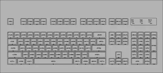

You can edit you own keyboard mapping by editing or creating a new symbols map from an existing map in /usr/share/X11/xkb/symbols
and you can get the current value of each key on your keyboard by using the following command:
xev | grep keysym
Here is the map of adresses of each hardware keyboard key keyboard keys
