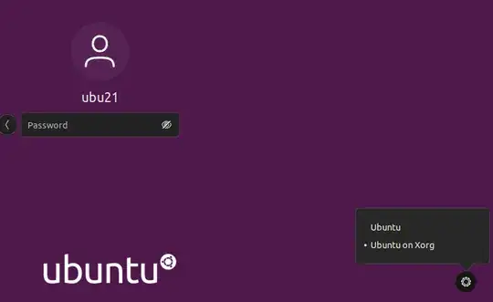

I recently bought a Dell Precision 7550 notebook. It came with Ubuntu 18.04 installed, but I wiped it and installed 21.10. On log in, I don't have the gear menu to switch between X11 and Wayland and Ubuntu defaults to Wayland on log in. As far as I tell, it runs Wayland until I open something (like Steam) that wants to use my NVIDIA card over my integrated card and then it switches to X11 for as long as it is using the NVIDIA card.
I would like to stick to just using X11 the whole time for now, but I can't seem to figure out how to get the option to choose X11 on log in to appear. Does anyone have any ideas as to why the gear icon might be missing?

If you look on to the right bottom you will see a small icon, that can be clicked:
Select "Ubuntu on Xorg" and X11 is actived.
If you can't see the icon, go to your desktop, open a terminal:
sudo nano /etc/gdm3/custom.conf Look for the line
#WaylandEnable=false
and remove the leading # sign.
