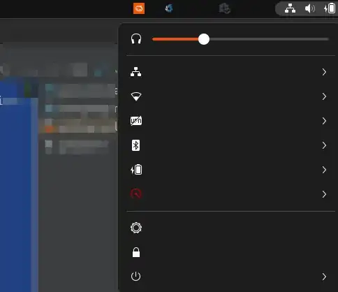

My main menu "loses" its fonts/glyphs(?) after some time. Without any recognizable trigger, the clock, calendar, app finder and main menu don't show (most) text anymore:
Main menu

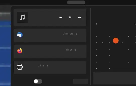

The same goes for the notification window, weirdly, some characters remain here:

The only workaround I could find is logging out and back in or rebooting the whole machine which is unfeasible.
I realize this won't be an easy fix, but I would already appreciate pointers to relevant log or config files, I don't even know where to start with this one.
