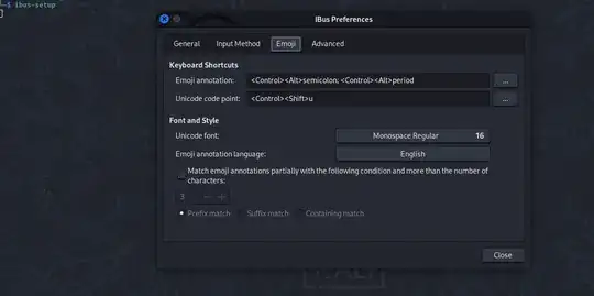

Description on how to change Ctl+. (period)
Open a terminal and type, so navigate to Emoji tab and edit that configuration, check the image below
ibus-setup
Bercove
  • 451
20
You may change this shortcut in ibus-setup , tab Emoji
