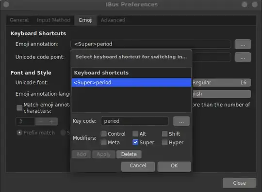

What you're seeing I believe is part of a means for quickly inserting emojis with the ibus input method framework. There's some details about it here and here, including I think a way to disable it.
Addition : Just for easy reference added shortcut change the process.
  • Search for IBus Preference
  • Go to Emoji tab
  • Change the Emoji annotation to anything else.
  • Click Apply
