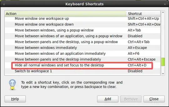

It can be found in System--->Preferences--->Keyboard shortcuts
alt text

Ctrl+Alt+D? You can set it in Gnome System->Preferences
