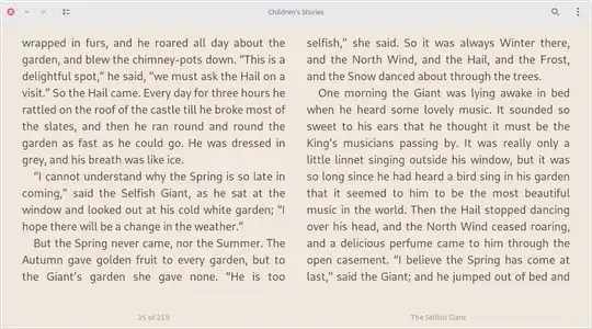

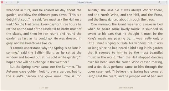

You probably better of with some manual coding. Create a file ~/.config/gtk-3.0/gtk.css and enter or adapt the following css code:
headerbar entry,
headerbar spinbutton,
headerbar button,
headerbar separator {
    margin-top: 0px; /* same as headerbar side padding for nicer proportions */
    margin-bottom: 0px;
headerbar { min-height: 24px; padding-left: 2px; /* same as childrens vertical margins for nicer proportions / padding-right: 2px; margin: 0px; / same as headerbar side padding for nicer proportions */ padding: 0px; }
Log out and then back in for the changes to take effect (or reset Gnome Shell with Alt+F2, r when on Xorg).
Foliate Ebook reader before changing gtk.css
Foliate Ebook reader after changing gtk.css
