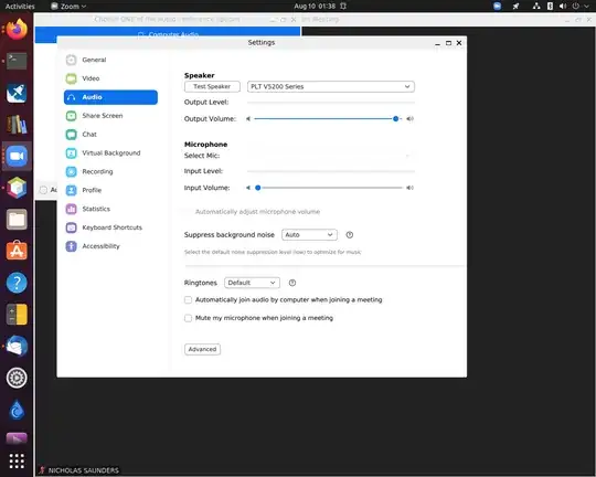

Where is the mic for a bog standard plantronics plt v5200 bluetooth headset?
The speaker test:
works fine.
There's no option to select a mic, however.

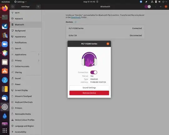

In bluetooth settings, the options are sparse to say the least:
