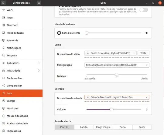

I tried to unpair and pair my headset and now I have a new option under Input Device:
Input Device:
  • Headset Microphone - Internal Audio
  • Internal Microphone - Internal Audio
  • Bluetooth Input - Jaybird Tarah Pro
Sound Settings
However, I've tried to select the last item and it doesn't seem to work. The level indicator doesn't move when there's sound.
Any ideas on how to fix that?

Card #4 Name: bluez_card.C0_28_8D_AF_C6_72 Driver: module-bluez5-device.c Owner Module: 30 Properties: device.description = "Jaybird Tarah Pro" device.string = "C0:28:8D:AF:C6:72" device.api = "bluez" device.class = "sound" device.bus = "bluetooth" device.form_factor = "headphone" bluez.path = "/org/bluez/hci0/dev_C0_28_8D_AF_C6_72" bluez.class = "0x240418" bluez.alias = "Jaybird Tarah Pro" device.icon_name = "audio-headphones-bluetooth" Profiles: a2dp_sink: Reprodução de alta fidelidade (Destino A2DP) (sinks: 1, sources: 0, priority: 40, available: yes) headset_head_unit: Unidade de headset (HSP/HFP) (sinks: 1, sources: 1, priority: 30, available: yes) off: Desligado (sinks: 0, sources: 0, priority: 0, available: yes) Active Profile: off Ports: headphone-output: Fones de ouvido (priority: 0, latency offset: 0 usec) Part of profile(s): a2dp_sink, headset_head_unit headphone-input: Entrada Bluetooth (priority: 0, latency offset: 0 usec) Part of profile(s): headset_head_unit
