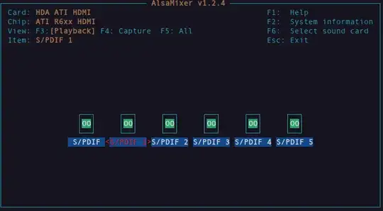

Below is my alsamixer screenshot which I don't understand - is something muted here? I cannot change the values of the "00" either by + or by the up arrow.

You should probably be seeing a different device available for sound output, something like "HDMI ...", as here. I don't think you should expect handling configuration for an S/PDIF device, in alsamixer or else.
