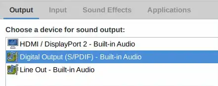

I have several devices detected:
devices
When I select the first, "HDMI / DisplayPort 2 - Built-in Audio", sound comes out of the speaker integral to my monitor.
When I select the second, "Line Out - Built-in Audio" sound comes out of the headphone jack I have connected directly to the sound card.

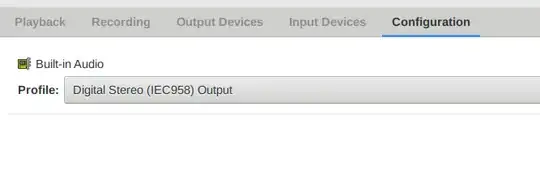

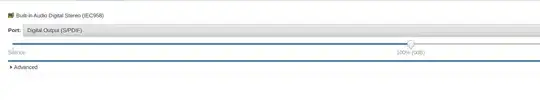

Everything appears to be set up correctly in pavucontrol:
Configuration. Again, if I select HDMI or Line Out, I get sound. Just not with S/PDIF: config Input device includes a monitor (is that correct??) input Output device shows bouncing bar on the vumeter: output

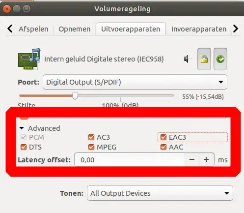

The answer is actually so simple that it's silly that it's not included in the default gnome audio control panel.
Step 1:
sudo apt install libavresample-dev pavucontrol libasound2-plugins-extra
Step 2:
pavucontrol
Step 3:
Tick all the boxes for the advanced audio codecs
Step 4:
Enjoy amazing sound over S/PDIF out (optical or coax) to a speaker set that supports it. enter image description here
