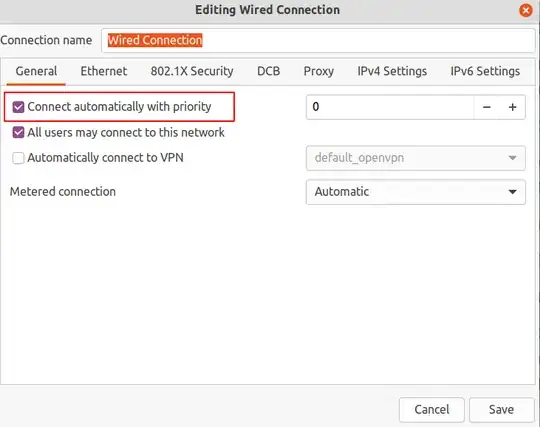

Try this... in terminal do nm-connection-editor and select your Wired Connection to edit.
  • confirm Device ethernet address
  • confirm WOL
  • change Link Negotiation to Automatic
    • or try Manual/1000Mb/full
  • reboot and retest
Also verify Connect automatically...
