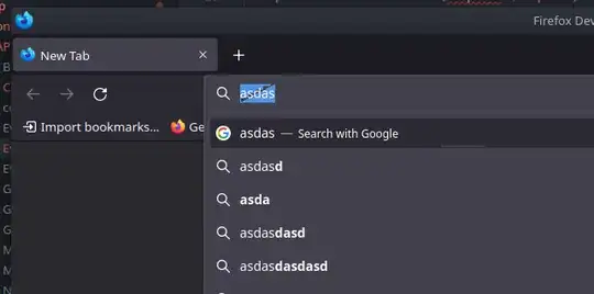

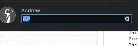

Despite reinstalling everything I can think of I am having an issue with certain highlights tearing. This issue has been present for me in both GNOME and KDE.
It seems to appear consistently while using Firefox and KDE Plasma 5 desktop, however I have seen it happen in other applications (ex: Ubuntu Settings and Dolphin). It seems only to happen in certain programs: Slack, VS Code, Atom, Gimp, and Google Chrome, have never given me problems.
All the tears seem to be from highlighting something or hovering over a button. Maybe the commonality is something to do with performing a fill?
I'm not the most experienced with Linux so I am thankful for any help.
I believe this person is having the same issue
Examples:
Firefox Application Launcher Menu

Exact same issue experienced - affected firefox also (unless webrender was set to force disabled). However I was using linux-image-5.8.0-55-generic:amd64. Reverting to kernel initrd.img-5.8.0-48-generic temporarily resolves the issue - but obviously cant stay on a kernel with patched security vulnerabilities.
Switching to (latest) kernel 5.4 permanently resolves the issue - however would like to know if some work is going on to rectify the issues with 5.8?

Finally figured it out!
After finding this question which has a reference to this answer.
Apparently since 5.8.0-49 and 5.8.0-50 there have been graphics issues (possibly only with internal Intel video subsystems). As seen above i was using Kernel Version: 5.8.0-55-generic.
By downgrading my kernel to 5.8.0-48 everything is magically better!
