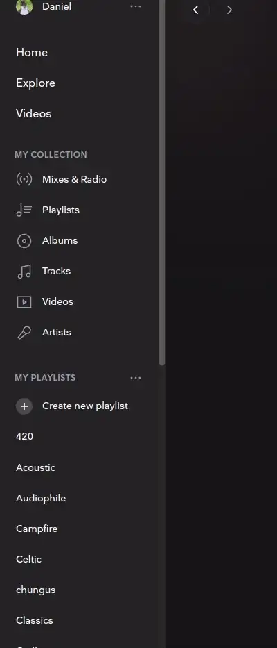

I haven't changed any terminal settings. This seems to be occurring in the entire OS. Here is another example:
flickering dock
Not sure how to go about troubleshooting this? I don't have the time to reinstall the OS, nor do I think I should have to because this is just ridiculous and shouldn't happen. I'm not aware of anything I've done to make the system unstable.

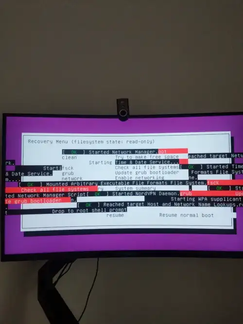

Earlier I also tried booting the PC. It failed and got stuck on some command in a terminal (didn't manage to take a photo of what it said).
So I rebooted into recovery mode with both available kernels. I was getting strange glitches like this:
dialog text disordered, colours mixed up

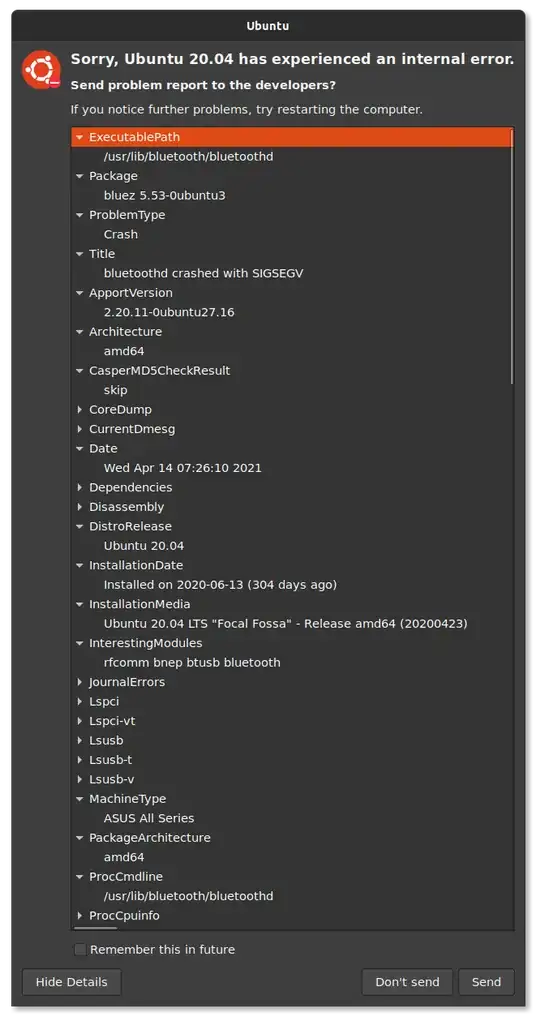

That didn't work. So I rebooted the PC normally, and now I somehow logged in fine. Now I'm getting popups saying to report a system error. It says this:
report error with bluetoothd
