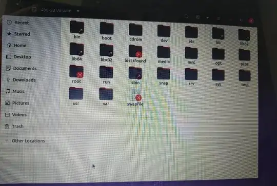

I created the USB and tried following a tutorial I found but I am at a loss of what to do. I clicked on "try Ubuntu" and then "files" then "other locations" then on what I think is my hard disk (called 496 GB volume, /dev/sda1) and when I click on it there's a series of folders.
Photo of folders
How can I access my actual folders/files?

There are several ways to do this but also on the newly fresh install you can prepare the system so you will not need to do this again.
In the standard installation Ubuntu creates only one partition for / (root filesystem) and everything goes there.
Your data is always in /home/<your_username>, and you can copy from there to the usb drive.
