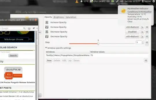

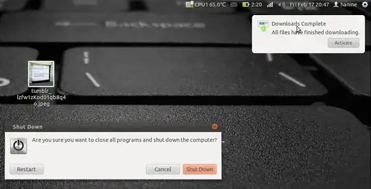

The day before yesterday, after an update, Gwibber Notifications got screwed a bit (Once I log in, they appear in bulk, for 2 seconds only while before they used appear one by one and each notification lasted 5 seconds). Anyway, After the same update, Top Panel Notification dialogs changed their background color from Gray (Ambiance default color) to Whitey very light grey. I can't spot where in Compiz Settings I can tweak this. I only can set the transparency values for items like Nautilus, Dialogs, Menus.... But no background stuff.).
Someone has a clue ? How can I set the Top Panel notifiations background color back to Default? First I thought it was only Gwibber, but it applies to any app (Firefox, Banshee....Etc).
Thanks in advance. Screenshot 1
Screenshot 2

Ok Found the problem and fixed it.
After installing Xubuntu-desktop along for some testing I did, xfce-notifyd (Xfce notification daemon) replaced notify-osd (Gnome Notify Daemon) and probably removed the ubuntu-desktop metapackage too.
Uninstalling the package xfce-notifyd , resolved the issue. Now notifications are back to normal.
Thanks for your interest.
