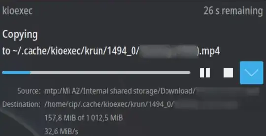

I want to open some videos located on an Android phone before saving them on local drive or any other location.
I can do that in Xfce. But on Plasma, when I want to open the video, Dolphin starts copying it in cache, that is on local drive, namely ~/.cache/kioexec/krun/.
If I wanted that file on drive before opening it, I would have copied it myself. But I want to save time and space and open the file directly. (That may be very useful if I want to process/transcode a large file: instead of copying on the local drive, one could set the phone location as the transcoder source and the external drive as the target.)
Can I do that on Plasma, given that is normal in Xfce and other desktops?
