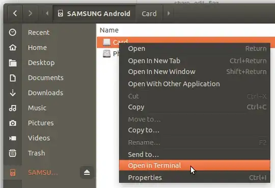

11
I don't know exactly to traverse to MTP location via terminal. However, I found out that we can right click on the Internal storage / SD card and choose option "Open in Terminal". Doing so the location is directly opened in Terminal.
screenshot
Pablo Bianchi

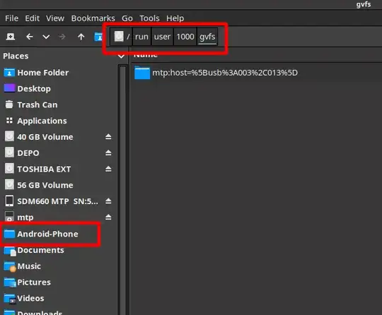

After accessing the correct path as said HERE and other answers, a good idea is to add the invariable path (for example /run/user/1000/gvfs) as a bookmark to the file manager left panel. When phone is disconnected, that folder will be empty.
I have noticed that there is a difference between the options available for a file accessed in this way and those available for the same file when accessed the "normal" way, by the mtp:// path (clicking "mtp" or the device name/numbers on the left panel): when accessed by /run/user/.../gvfs the file has in context menu ("Open with") all the expected options; these options are limited (reduced to default/vanilla ones) when the file is accessed by mtp://. Also, some programs (e.g. MKVToolNix) cannot access a file by the mtp:// path, but they can by the other one. This aspect may become important is some scenarios, like for example when one needs to create/download a file on the phone, process it through a computer program (e.g. MKVToolNix) and output it on an external device.
