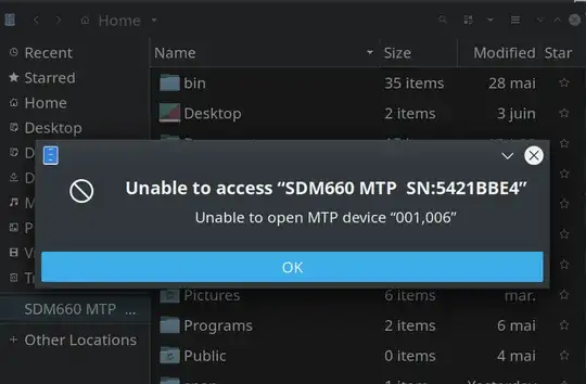

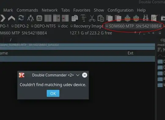

Double Commander doesn't see the phone I guess until it is accessed in the main file manager, but after that the phone location would appear in the list of drives. It does the same in KDE, only when clicking the drive it shows an error:
The same does Nautilus:
Clicking that in Thunar has no effect whatsoever.
