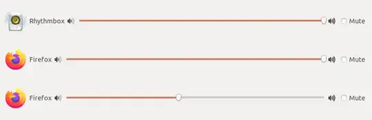

I have recently begun having a very annoying issue with audio playback in Firefox 87 (Ubuntu 18.04 with Unity Desktop; application-based volumes are a thing there too), possibly due to a Firefox update (which I didn't notice, but I'm fairly sure the version number is higher). I had assumed that it was due to a number of other listed issues (such as Inconsistent Sound Volume Ubuntu 20.04 or Firefox keeps resetting Pulse volume to 0), all of which I have tried.
However, I just noticed that the issue is only with Youtube videos (so far). In fact, the regular volume is being kept just fine (the example was a HTML5 music player) as shown in the first Firefox entry. The second one appears only while Youtube is being played, and apparently deletes itself or disappears and resets the volume to a bit less than 50% every time I pause or stop a video. This is playing merry hell with my audio preferences since I'm alternately deafened or unable to hear what I'm trying to watch.
Youtube spawns a new Firefox application instance every time sound plays
Does anyone have any ideas? I've even looked for "volume" in about:config and those seem normal...
(Also, is this spawning a bunch of configs in my audio settings app for all the new Firefox profiles? I'd hate to be accidentally filling up my precious SSD space with one-off never-to-be-used again audio profiles)
