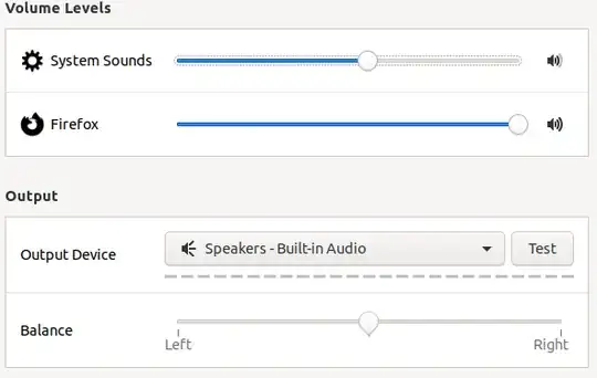

I upgraded from 18 to Ubuntu 20.04 a few days ago. I listen to music through Google Play Music's website which I load in Firefox. I noticed that now Ubuntu has app specific volumes (cool). Since I stream shows and movies through Firefox I decided to crank the Firefox volume to the max and then fine-tune the volume on the website and with the system's master volume. The problem is that the sound for Firefox keeps resetting. In fact, it seems to reset with every Google Play song. I go from being able to hear my music to hearing silence. Why does this happen and can it be stopped?
Volume Levels
For the moment, I'm leaving the Firefox volume to where it defaults and increasing the volume on the website.

When I watch an mp4 video in Firefox, let it be embedded in a webpage, or opened from the disk via file:// protocol, and I use this video's HTML5 video controls to lower the volume, then I get something similar what you have on your screenshot: the Firefox tab's volume slider will "follow" what I did on the mp4 video's volume control. And then sometimes I get freshly opened tabs with the volume a little bit tuned down by default, or even, sometimes, muted completely.

If the master volume is set to half, then in the gnome-control-center's Sound settings, the Firefox tab's volume will be displayed accordingly, also at half. In the sound settings, as long as I move the Firefox slider to softer than the master, the volume levels can be de-coupled; but if I move the Firefox tab's volume louder, as soon as it reaches the level the master is on, it starts to pull the master volume level with it. So when the Firefox slider reaches 100%, master will also.
