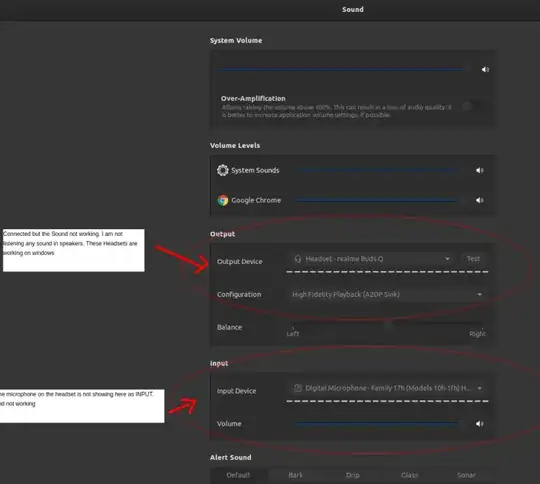

Bluetooth headset connected but the sound is not working and the mic is not showing as connected in newly installed Ubuntu 20.04. I have tried many solutions but unfortunately failed.
Can anyone Please Help me? I have attached an Image to understand the issue:

Here is the detailed article I have written to resolve this problem, the steps of which I'm also adding here. You can follow it and most probably be able to solve your problem.
Bluetooth headset microphone not detected
Open your terminal and follow these steps:
We will use a PPA for adding Pipewire to Ubuntu 20.04, which is maintained regularly:
sudo add-apt-repository ppa:pipewire-debian/pipewire-upstream
To update the PPA packages in your system do:
sudo apt update
Install the package:
sudo apt install pipewire
There is also a dependency needed to be installed with Pipewire, otherwise you will face the issue of “Bluetooth headset won’t connect after installing pipewire”. Install the dependency by:
sudo apt install libspa-0.2-bluetooth
Now, to install the client libraries:
sudo apt install pipewire-audio-client-libraries
Reload the daemon:
systemctl --user daemon-reload
Disable PulseAudio:
systemctl --user --now disable pulseaudio.service pulseaudio.socket
If you are on Ubuntu 20.04, you also need to “mask” the PulseAudio by:
systemctl --user mask pulseaudio
I am not sure but, if possible, you can try to run this on other versions too. 9. After a new update of Pipewire, you also need to enable pipewire-media-session-service:
systemctl --user --now enable pipewire-media-session.service
You can ensure that Pipewire is now running through:
pactl info
This command will give the following output, in Server Name you can see:
PulseAudio (on PipeWire 0.3.28)
Things should be working by now and you can see your microphone.
If it doesn’t show up, then try restarting Pipewire by this command:
systemctl --user restart pipewire
If it’s still not showing your microphone, you can try rebooting once and remove and pair your Bluetooth device again to check if it works now.
I hope I have helped you solve your problem.
