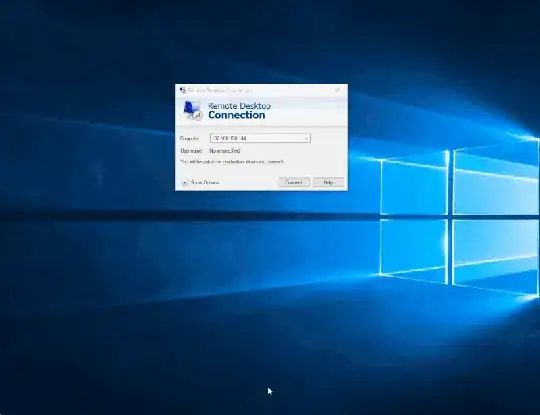

After that, use Windows remote desktop app if connecting from windows or remmina if connecting from Ubuntu as clients.

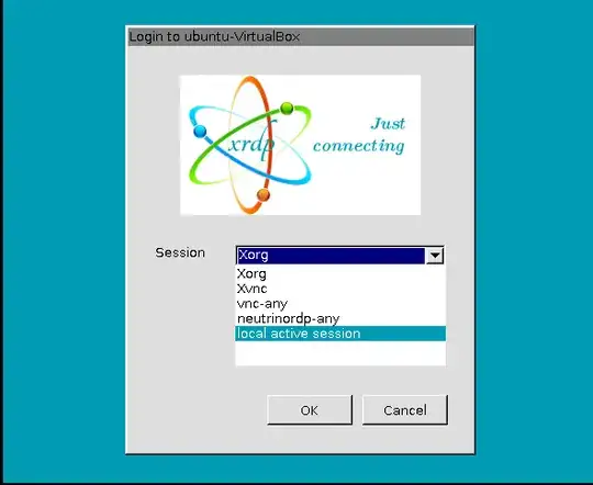

Next, connect from a remote machine and choose Local Active Session from the Session drop-down menu when you see this screen:

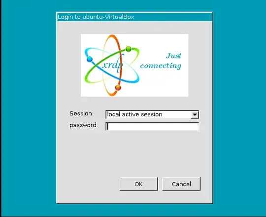

Then, enter the password you set for screen sharing and click the OK button when you see the password field that looks like this:
