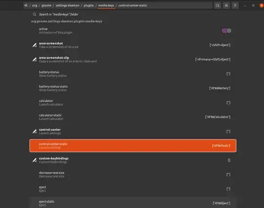

However, in my case this solution didn't work, and I had to do it through the dconf-editor, which worked:
$ sudo apt install dconf-editor
$ dconf-editor

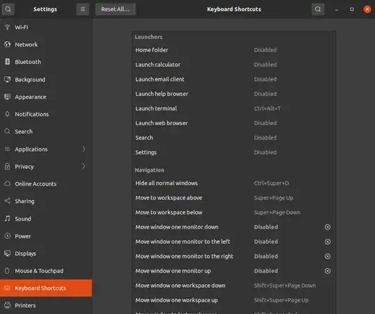

After that change the appropriate settings in the GUI:
