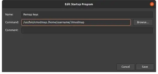

Here's an outline of a procedure to make the mute and volume keys do something else. It breaks if you change the keyboard layout, e.g. if you switch between two languages.
  1. Make an xmodmap file that describes the key remapping. Typically it's a file called .Xmodmap in the home directory, but it could be called anything. The content should be:
keysym XF86AudioMute = XF86Launch5
keysym XF86AudioLowerVolume = XF86Launch6
keysym XF86AudioRaiseVolume = XF86Launch7
(1b: You can test it by running `xmodmap ~/.Xmodmap. It should produce no output, and the volume keys should no longer do anything)
  1. pen Startup Applications on the desktop (Search for it). Add an entry to run /usr/bin/xmodmap /home/username/.Xmodmap. Replace "username" with your own username (the usual $HOME or ~ won't work because the command field is not a shell).
Name can be anything, command as given above, comment blank
  1. Now you can map the volume keys to other actions in the settings
