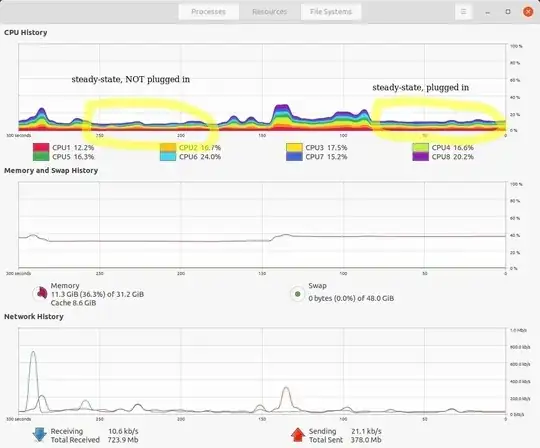

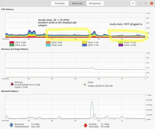

CPU usage
I was able to drive a 4k 60Hz monitor over DP and a 2k 60Hz monitor plugged into the same adapter at the same time through an HDMI to DP adapter.
On my super powerful 20-core Dell Precision 5570 laptop running Ubuntu 22.04, I didn't see any noticeable increase in CPU usage. But, this is a very powerful computer.
On my much weaker 8-core Dell Latitude 7490 laptop running Ubuntu 20.04, I saw an increase in CPU usage of a few percent. See images below. But, it was still very usable.
