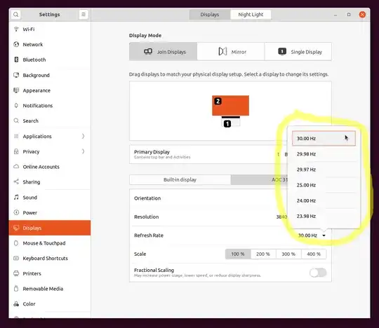

In my Ubuntu 20.04 display settings on a Dell Latitude 7490 laptop, I can set my laptop monitor to 1920 x 1080 resolution at 60 Hz, but I cannot set my AOC CU32V3 32" 4k monitor to 60 Hz (see screenshots below), even though the monitor supports it. It feels laggy, so I'd really like to increase the refresh rate to 60 Hz. Any idea how I can do this?

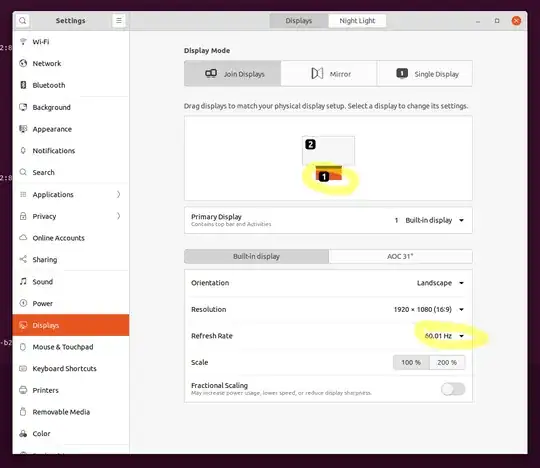

Laptop monitor is 60Hz: enter image description here
External monitor supports 4k (3840 x 2160 resolution) at 60Hz refresh rate, but I cannot set it to 60Hz: enter image description here
Notice there's no 60Hz option: enter image description here

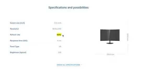

Proof the manufacturer says it supports 60Hz at 4k:
https://us.aoc.com/en/monitors/cu32v3 enter image description here

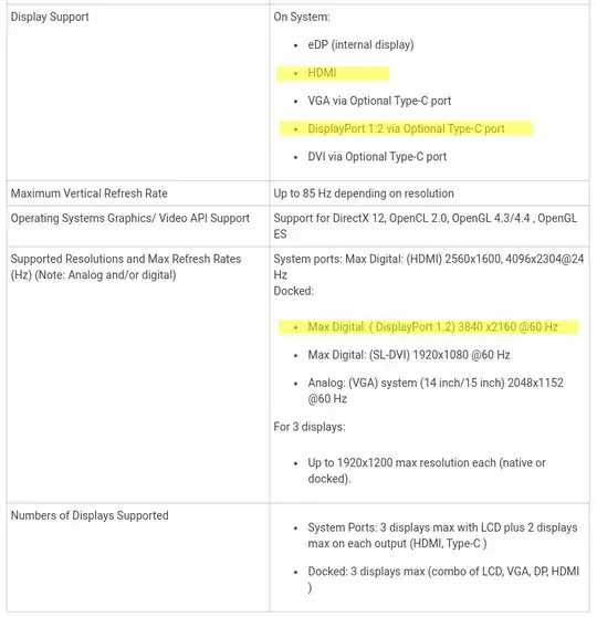

Info on my laptop's graphics card (Intel HD Graphics 620):
I'm currently connected with a High Speed HDMI cable in HDMI 1.2 mode. Am I to understand that I must use a USB C to Display Port adapter and the Display Port to get 4k at 60Hz, perhaps, instead of HDMI?

It turns out it was just a hardware limitation of HDMI, so you have to use Display Port instead! So, I bought this USB C to Display Port adapter for $15 (you can try this one or this one if that one is out of stock), plugged in my Display Port cable that came with the monitor into it, and voila! It works perfectly! 4k (3840 x 2160 resolution) at 60 Hz is now an option and it works perfectly!

You need HDMI 2.0 cable and HDMI 2.0 capable graphic card for 4K @ 60 Hz. Your laptop only supports HDMI 1.4 hence the limit to 4K @ 30 Hz
https://www.dell.com/community/Latitude/Latitude-7490-Connecting-an-external-1080p-and-a-4K-display-lid/td-p/7433161
