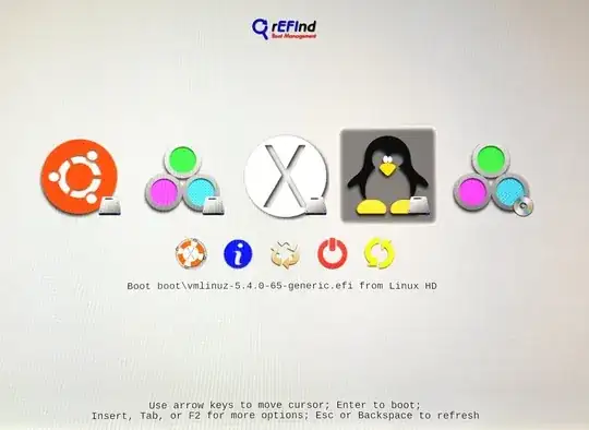

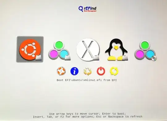

Regarding rEFInd this results now in a configuration in which two vmlinuz.efi boot options exists. The first is located in the esp partition sda1 and can be loaded directly from the Apple stock EFI loader. The other one is located in the root partition sda4 (or in its boot folder). That second vmlinuz.efi can be loaded from rEFInd but not from the stock Apple loader. Conversely, rEFInd seems unable to load the first vmlinuz.efi file without additional information regarding the root partition. (The boot process will hang and a BusyBox shell will be displayed.)
Optional further steps, only necessary on restricted "vBIOS not exposed in EFI" systems:
As mentioned at the beginning, it is sometimes necessary to start only the bare Linux kernel (without the "vmlinuz loader") directly from rEFInd to avoid tough problems like the "vBIOS not exposed in EFI" issue. In this case, the kernel must also have an efi extension. This requires a manual adjustment because the kernel name changes with every kernel update. The syntax may look like:

To establish a bare Linux kernel booting directly from rEFInd, the following command is required. It is very important to understand that this requires an ongoing manual adjustment because the kernel and kernel name changes with every kernel update. So check first out which kernel version is present! ;-)
sudo cp /boot/vmlinuz-5.4.0-72-generic /boot/vmlinuz-5.4.0-72-generic.efi
In some situations it may be necessary to delete the previously generated vmlinuz.efi file. But I recommend to try it first out without deleting it.
sudo rm /boot/vmlinuz.efi
As the last step it is recommended to install the rEFInd PPA. This will automatically update rEFInd to the newest release. Regarding (K)Ubuntu this can be done quite easy through the official rEFInd PPA from Roderick W. Smith:
sudo apt-add-repository ppa:rodsmith/refind
sudo apt-get update
sudo apt-get install refind
Alternatively it is also possible to skip this step and boot rEFInd always from CD.
That's it! Reboot the Mac and choose in rEFInd the Linux kernel (with the efi extension). K(u)buntu should now boot fine also on systems which doesn't expose the vBIOS under EFI.

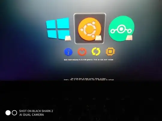

No, if you're trying to run something from disk (.img), you should use the path to the options structure.
\options "root=/dev/ram0 where screen format can also be used ~ video=1366x768 UVESA_MODE=1366x768"
In addition, you do not mention the disk formats, which is important.
In standard mode (unpacked), the following should be written on your screenshot...
Boot boot\vmlinuz-5.8.0-50-generic from 24 GiB ext4 volume
The other axes should not have ext4 format, and you should specify the options or .efi file for axes.
boot screen
