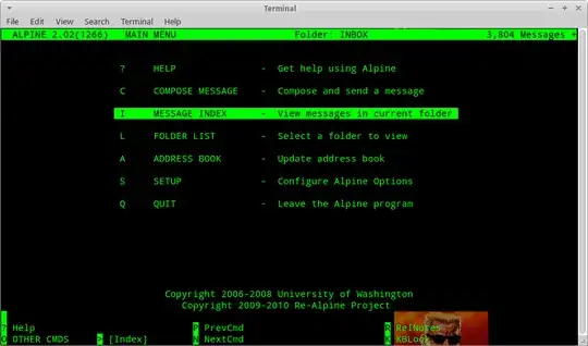

Now save and exit back to the menu. Now with this basic setup you should be able to read and send mail. If you want, you can exit the program and the load it up again to check everything has configured correctly, and the main screen should be something like this:
