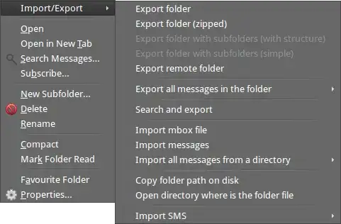

  • You need to install the ImportExportTools addon in Thunderbird, then restart the program and now any folder you right click will have the necessary export options (screenshot 1).
  • Now choose your folder in Thunderbird and then right-click it and you must choose the first option 'export folder', and select the location it is to be saved in (i.e. your mail folder in your home folder). It will create by default a single mbox file of the folder and the file will take the name of that folder exported.

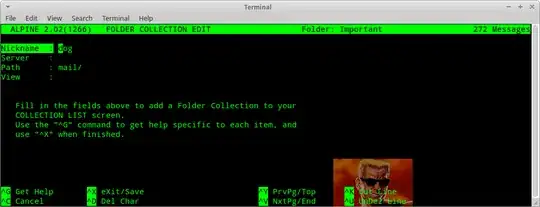

  • Now make sure that single exported file is in your mail folder that Alpine uses, and open Alpine and go to setup and then click lists (L), and then Add Collection (A). Now (see screenshot below) type any old nickname for the collection (the actual name will be the mbox file name, which is called important in my case).
  • Then fill in the 'path'- i.e. the location of the file; just leaving it mail/ is good enough for Alpine (see screenshot) if the new file is in the base of that directory, although for later folders you will need to use mail/local/, for example. But always specify them like this, without the actual name of the file, just the folder location. (see screenshot below). You can leave 'server' and 'view' blank. Save the changes and exit that menu.

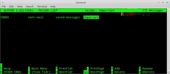

  • Now just go back to the main menu and select folder list and select the new folder list entry (whatever it is called- see screenshot 3), and then you should see your new folder (see screenshot 4).
Here's the screenshot (number 4) showing the newly imported mails (from another folder I created, called random):
Just repeat this process for any other folders or when you want to update them.
