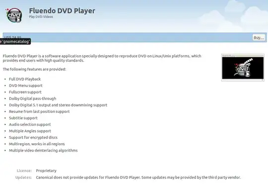

One way to do this is using the Fluendo DVD Player available (for $24.95) in the Ubuntu Software Centre. This would ensure you can always play all DVDs as it is software supported by a company.
NB: Purchasing this also has the side effect of protecting you from any legal issues.
NB2: I'm sure someone else with more knowledge than me will be able to give you a 'free' solution.
