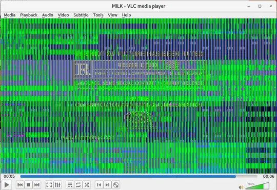

Here's a screenshot of VLC Media Player on a DVD: Wierd looking screenshot
IF I try to play a CD by using Videos, it says that "DVD Source is required to play the file, but is not installed" If i follow the link from there to Software, it displays a big frowny face, presumably because it is not a happy camper. Yes that is literally what happens.
Pretty much everything else works on the screen - websites display normally, programs work fine.

I was able to find the answer in this Youtube video:
https://www.youtube.com/watch?v=wN9tGhmRvns
Which recommends disabling hardware accelerated decoding in VLC's settings panel.
