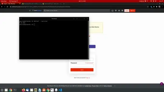

I have installed dotnet on my Ubuntu 20.10 but for some reason I want to remove it but I don't know how to do it please help.
