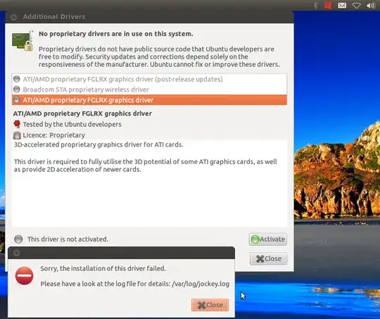

Broadcom 802.11 Linux STA wireless driverfor use with Broadcom's BCM4311-, BCM4312-, BCM4313-, BCM4321-,BCM4322-, BCM43224-, and BCM43225-, BCM43227- and BCM43228-basedhardware.
And
3D-accelerated proprietary graphics driver for ATI cards.
This driver is required to fully utilise the 3D potential of some ATI graphics cards, as well as provide 2D acceleration of newer cards.
will not instill is there anyway for me to make a copy of the drivers via usb HDD and then put them on new upgraded version.
12

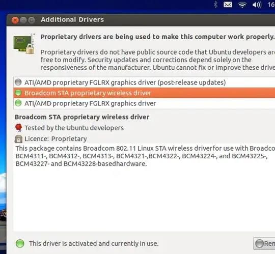

This worked to re-install the wifi drivers now my wifi is working.
I wondered if maybe this would also work for the graphics driver for my ATI/AMD cards. So I tried to re-install the graphics drivers and this also worked.

GUI window showing activated Broadcom proprietary wireless driver
As you can see, now all seems to be working.
