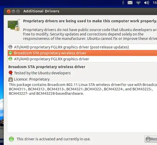

  1. Open Synaptic Package Manager.
  2. Uninstall bcmwl-kernel-source package.
  3. Reboot.
This should cure the problem. :-)

Dell Upgrade to 13.04 & 13.10 No wifi, graphic card driver and bluetooth Problem? This may help
By Using the command :
sudo apt-get remove bcmwl-kernel-source
sudo apt-get install bcmwl-kernel-source
This worked to re-instill the wifi drivers now my wifi is working.
