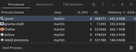

First of all, when I close all the windows related to Zoom via Top Bar
All the instances disappear from the task bar, but the proccess won't end on the system monitor as shown below:
Zoom on System Monitor Still Open
This wouldn't be a problem if I didn't need to end it before opening Zoom again (which is another problem by itself). Every time I close all the Zoom related windows I have to go to system monitor to end the process. Otherwise, If I try to open again the application I won't get any answer from the computer.
Finally, there are some cases when Zoom randomly crashes showing the following message:
However, when I open the system monitor the zoom process is still running, so if I try to open the application again I get no response until I kill the process on system monitor.

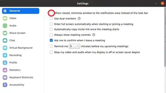

Check Zoom Settings
First, let us change the default setting so that you are visually reminded that Zoom is not closed when you click the ❌ button.
Click on the Zoom settings cog icon on the top right of the Zoom window.
On the General tab, uncheck When closed minimize windows to the notification area instead of the task bar.

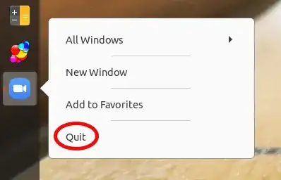

Note, this will not close zoom when you click on the close icon ❌. But now you will see that Zoom was not really closed. You can close Zoom by using the context menu of the Zoom icon on the Dock.
