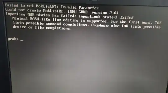

Storage screen recognizes the RAID array with expected size (~ 4 TB) and can even auto partition it with default values. After reboot, I can't boot in the system. It falls into GRUB2 console with below error:
Error says failed to set mok list r t, invalid parameter; could not create mok list r t, i gnu Grub version 2.04; import m o k states has failed, function import_mok_state() failed; after that it falls to a Grub bash screen

Can you boot ubuntu from installation usb then from terminal run
sudo grub-install /dev/sda
and then
 sudo update-grub
