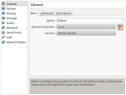

  • The virtual machine from Virtual Box Manager needs to be set to 64-bit in General -> Basic settings:

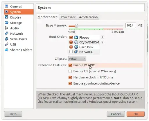

  • In addition, for running 64-guests it is recommended to enable the Input/Output in the System -> Motherboard settings for your virtual machine:
