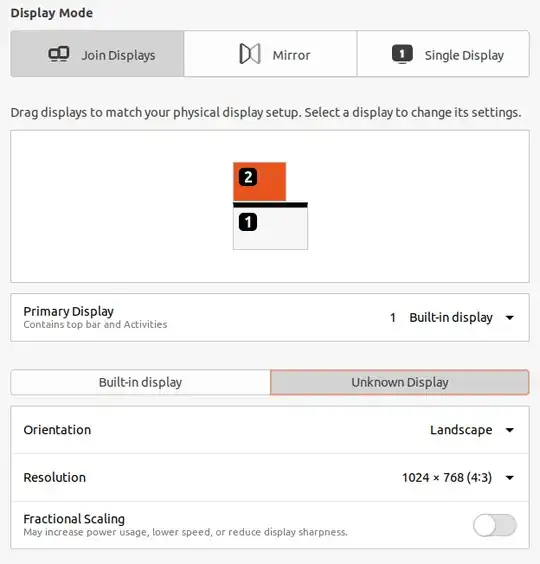

I recently updated from Ubuntu 18.04.4 to 20.04.1 on a Lenovo T400 2765. When I connected an external Fujitsu Siemens P19-1A monitor via VGA it is shown as "Unknown Display" in Settings > Displays. This was not the case in Ubuntu 18.04.4.
Screenshot of Settings > Displays
Also, the native resolution (1280x1024) is not available.

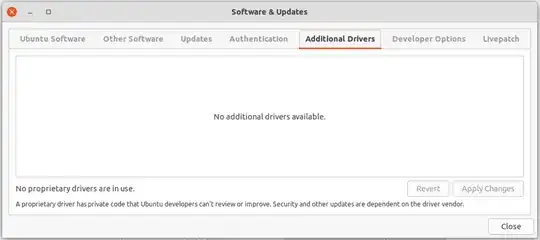

There is no additional drivers installed:
Screenshot of Software & Updates > Additional Drivers
