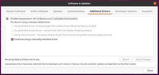

The main problem is that the screen don't fill up the display. In the settings --> displays, it says it is a 'Unknown display. The display are a common HP S2231a.

In Software & Updates--> Additional drivers have 4 rows,
Number 4 is choosen, and the other 3 row are greyed out, and not possible to select them
I have no idea what manual installed drivers are, and I have not doing anything manual.

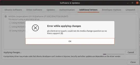

Edit. After help from @heynnema I purge the nividia-driver and ubuntu use Noveau-drivers
I tried just now to add Nvidias propretarian drivers but get this error message: enter image description here
