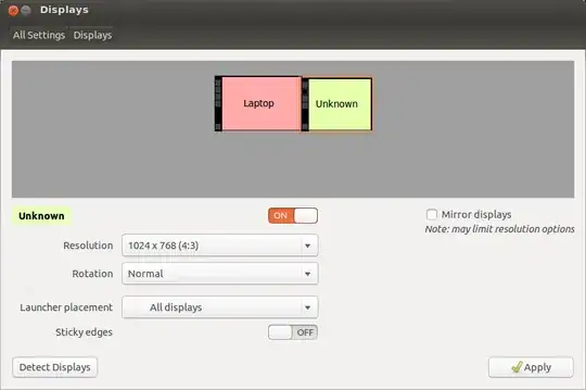

I have a Dell laptop with an external monitor attached (a Samsumg SyncMaster 931c).
My laptop display was recognized, and I can adjust its optimum resolution.
My external display is still unknown, thus I'm stuck at a lower resolution (1024x768):
I tried the "Detect Displays" button, but it didn't work, nothing happens.

It seems I wasn't even using nvidia before, as I guessed by looking at my additional drivers configuration:
My laptop has an Intel chipset, I guess:

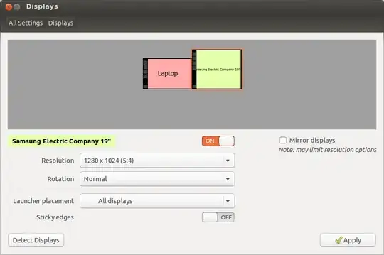

The monitor cable was loose.
When I removed the cable and firmly plugged it in again, everything suddenly worked.
The monitor was recognized, and now I am using my previously desired resolution: The monitor was recognized
I feel kind of silly, because I never thought merely touching a loose cable would be of any help.
