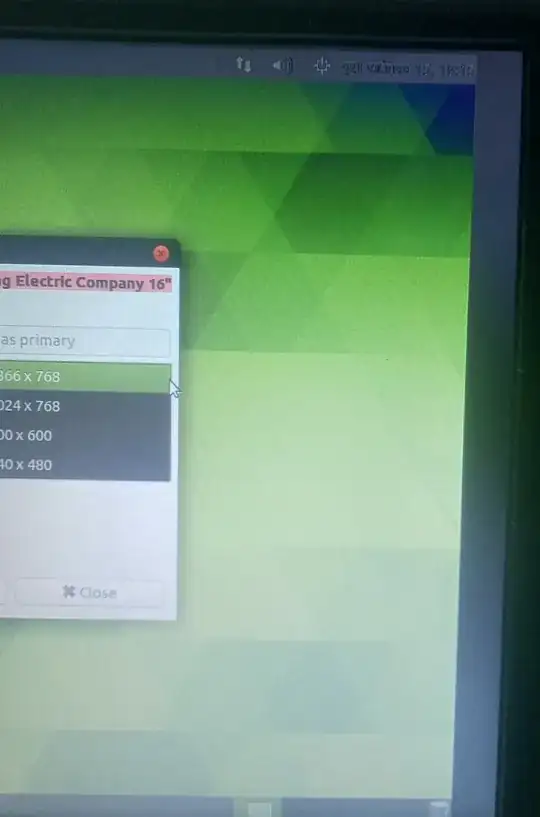

How can I solve this problem that after installing Ubuntu mate 18.04.5, the monitor doesn't show its full screen? Please help me!

I had this before, my fix was changing my refresh rate from 60hz to 59hz. However I see yours detects as a 16" screen in your picture instead of 15.6.
xrandr is your friends
Try these command
xrandr
xrandr --listmonitors
xrandr --prop
What you want to is perhaps something like that:
xrandr -s 1440x900 -r 60
If no definition is available, you can use custom config: How to permanently set a custom resolution? How do I set a custom resolution?
