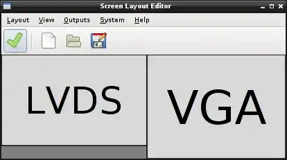

You can use a GUI frontend to Xrandr, for example ARandR.
ARandR is designed to provide a simple visual front end for XRandR. Relative monitor positions are shown graphically and can be changed in a drag-and-drop way.
Quoted From http://christian.amsuess.com/tools/arandr/:
Features: Saving configurations as executable shell scripts (configurations can be loaded without using this program)
After choosing your suitable configuration Then apply the new configuration by pressing Ctrl+Enter
To install it in Ubuntu:
sudo apt-get install arandr
Now your configuration will be stored and loaded within the startup
