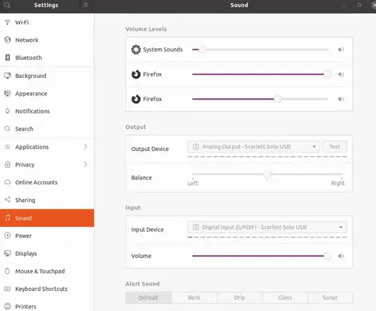

I cant make a screenshot while the option menu is open, but in here:
I always have to reset my output device to "Headphones". It also contains HDMI output, "Scarlett SOLO Output Digital" and "Scarlett SOLO Output Analog" but I never use any of them. Can I disable those to avoid the hustle to select my headphones after every restart?
Same with my input device, I only use Scarlett Digital input, but not Scarlett Analog Input, nor my internal microphone, nor the microphone of my separate webcam. Ever.
Can I disable all of those options? I constantly have to go there and correct the selection.

Instead of blacklisting the output/input devices, one can disable the automatic audio change on startup:
In /etc/pulse/default.pa comment out module-switch-on-port-available:
# load-module module-switch-on-port-available
Then restart.
Source: How to prevent automatic change of the audio device?
