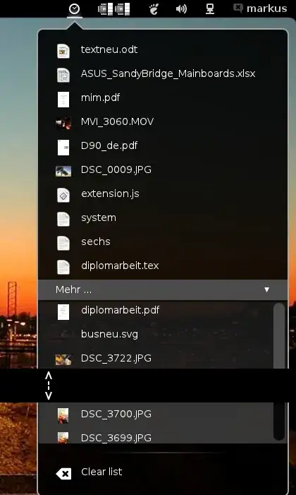

This works even in GNOME 3.2 with the extension Recent Items.
