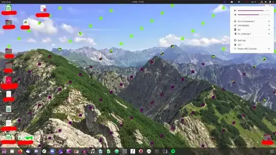

I updated from 18.04 LTS to 20.04 LTS and now my Desktop and the text in the toolbar have weird graphical glitches (see screenshot). They different every time I restart.
Does somebody have an idea what could be the problem and where I should start looking? My first guess would be that some module got removed accidentally but I wouldn't know which one.
I also tried to reinstall ubuntu-desktop.

Have you tried installing the correct drivers to the videocard? Or, alternatively if You already have the correct drivers; have you tried to go to software-updates (I think it's in the terminal called gtk-software-properties) and Checked there if you can choose (at the Drivers tab) some other Drivers?

The answer from:
Fuzzy graphics after upgrading to Ubuntu 20.04
sudo apt purge xserver-xorg-video-intel
"Reboot and everything is back being normal."

This has been solved another question.
followed by a reboot and everything is back to normal.
